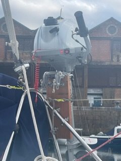

I made this for mine. It’s just scrap of sapele with some “horns” glued to the upper to prevent it wandering off sideways before you have the clamps tight. There’s also a tether which isn’t attached in the pic.
