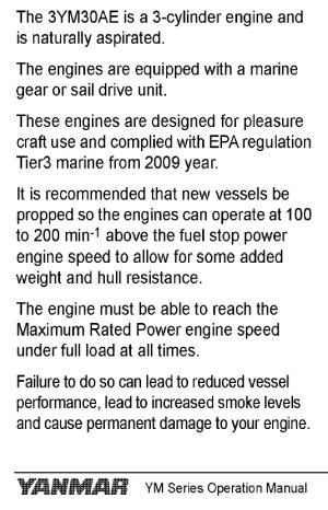

I don't think you can look at the prop in isolation. For our engine, it's recommended to motor at 80% of the fuel stop limit, ie 2,600rpm. The Operations Manual for the engine on our boat (AWB sailing vessel) says:

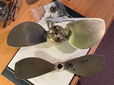

This photo I’ve found online gives you the idea of blade difference between the Radice I have now and what a flexofold looks like. The difference in the blade area looks huge.
A folding propellor will not cause drag - thats the whole point. So the bigger blade area of the flexfold will give better grip in difficult conditions without losing sailing performance. The shallower pitch of the bigger diameter will enable the engine the engine keep its revs up when it is having to work hard.
