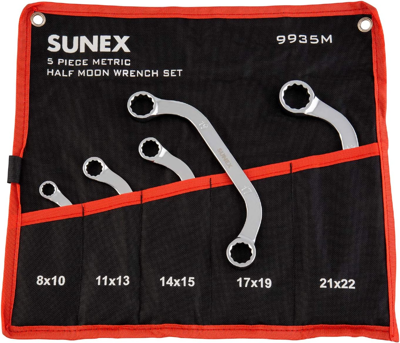

Could these help remove the bolts?
Or get an old spanner warmed up and bend it.
