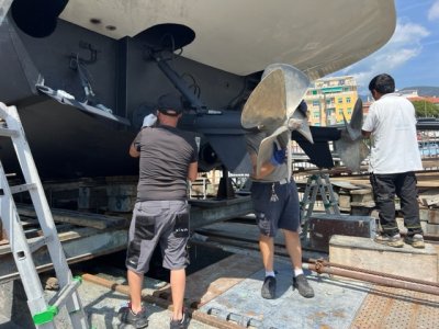

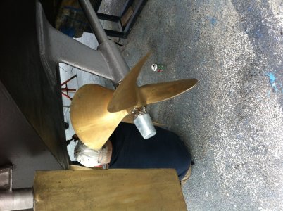

All I know is the props have to be very clean, no idea how to apply…….done by others !
I’ll let you know in a few weeks if it’s any good.

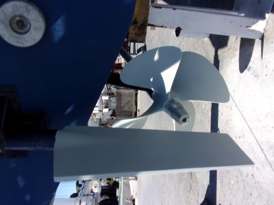

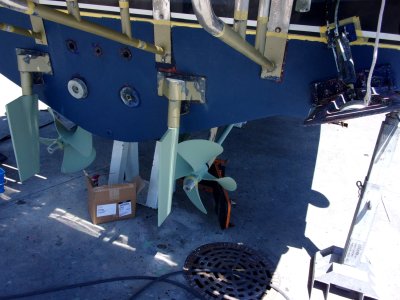

Amico use this stuff .It works .
Under coat ^ first or primer .
Finished stuff .^
I have asked what it is but got no real answer .It comes on the invoice as ” surface preparations and covering of shaft , propellors and rudder @ €118 X 2 .+ tax later .
It works what ever it is .Seeing as threads about finding the holy grail of stern gear protection regularly crop up on here .I will endeavour on the forums behalf this yr ( June ) to find out from the yard the specific name of the stuff .
If you revisit the first pic there’s a gold primer on the SS bathing platform, rudder stocks as well .
It all works in season what ever it is .Wish I could tell you all exactly what it is .
I don,t think I could buy a tin of “snake oil “ for stern gear protection for under £250 let alone apply it correctly …..and by beginners fluke ends up working !

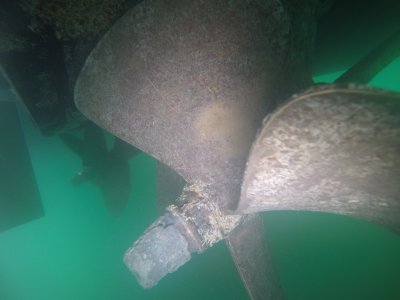

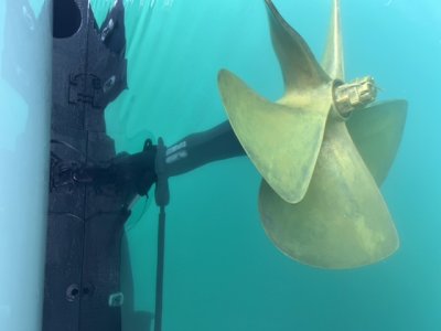

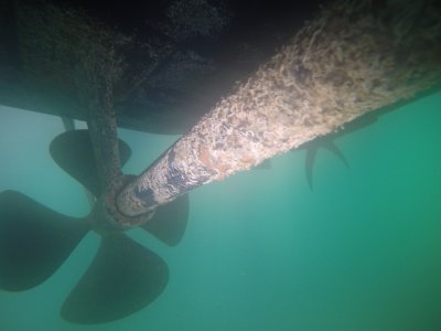

Up to now I have given up everything I have used previously,- a la Jountventurel - just ripped off so I gave up and prepped back to shiny metal for the past decade or so ,and in season dived in and manually scrapped them like everyone else .Just gave up .
like this .
Yard ^ in France .
^ Typical growth after a few weeks of inactivity in the Med , with no protection .
This is all history now with Amico in Italy .

Portos pictures look like Velox primer and topcoat. They are mad for it on props and shafts etc here in the Western French Med.

I've used Velox Plus (the stuff in Porto's photos, I think) and Propspeed, both many times, in the Med. Both are pretty good imho and far far better than nothing, and sometimes almost perfect, but I think Velox is very slightly better and more consistently good. By which I mean I hear more stories of Propspeed not working, but then of course it seems a more widely used and marketed product.

Yes that's definitely Velox, we had it on the San Lorenzo a few years ago. A fair bit cheaper than Propspeed if I remember correctly.
Seemed to do just as good a job - the key with both products seems to be to never let the boat sit for more than a couple of weeks at a time (in the Med, during summer).

These coats work but are very technique sensitive.Not only that but probably some environmental parameters need meeting too , ie air temp , humidity etc , metal temp , dew points etc etc a narrow ish window .Plus the basic mixing the stuff if it tends to settle out in its container??
Reading prop speeds blurb it does say rub down the surface and even specify the grade of sandpaper .
You gotta roughen up the prop surface .Look carefully @ the guy with blue gloves in the pic above on Chris s boat .
Then reflect what hurricane said .Polished smooth surfaces , the trad way .You can’t have both with prop speed .The two systems conflict .
