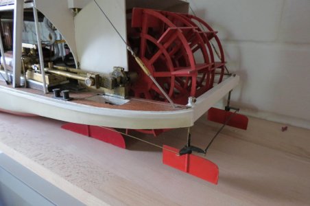

while researching steering, the most common answers i found were - twin rudders either forward of the paddle wheel, or aft of it, sometimes both,, some people advise an additional rudder at the bow, others advise an additional rudder either side amidships, the option that intrigues me most is the curiously named "monkey rudders" which seems to be a rudder either side of the paddle wheel, that i assume sits slightly below the wheel, with another rudder aft of the wheel (see attached picture of a model utilising this system), initially i will see how i fare with 2 rudders in front of the paddle wheel

A paddlewheel is a very interesting and unusual choice. What sort of size paddlewheel do you imagine?
A rudder works very well with the thrust of water over it so i would have thought behind the paddlewheel would be the best location plus it can minimise the rudder draught.
