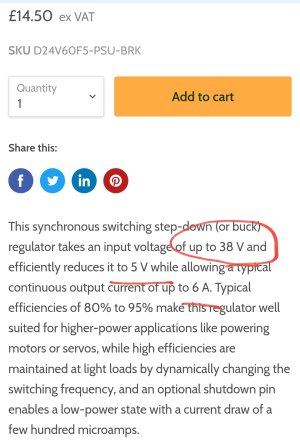

I've used things like this and found them to be reliable although that particular one is over the top in terms of power if only driving a Pi. A 4A version should be ok. It's just a simple buck DC-DC convertor but they seem to handle any transients very well so the power to the Pi is stable.
For more protection then some sort of UPS for the Pi is worth investigating to go between the Pi and the supply. I'd try to have it on its own switch/fuse/breaker at the power panel.

How about their 'up to 38v input step down to 5v 6A'

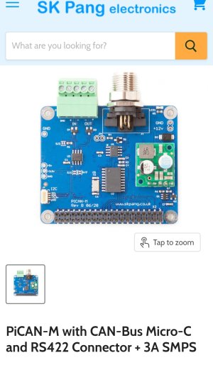

If you're going to end up connecting the Pi to NMEA2000, SKPang even provide a board that will take the power for the Pi from the NMEA2000..
