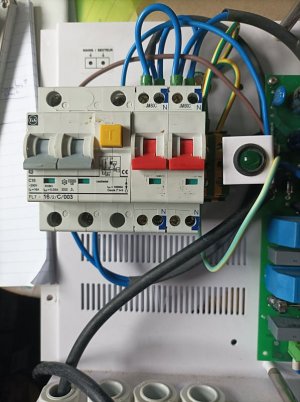

Hi all.
The battery charger aspect of this box seems to be failing. Whilst on mains shore power my batteries are not charging, and I am having to resort to starting the engine to get a charge in. I have tried to find some info/docs on this unit to no avail. I presume its French as it looks like an original fitting to my Beneteau 323. The green POWER ON LED no longer lights, although the 240V circuits both still function correctly. When I get the time I'll disconnect it and pop the cover off in the off chance there is a fuse within.

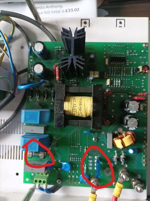

I have just been through this with one on my Beneteau 331. Did not seem to be getting any charge out, just voltage of 12.8v. However in your case if green light not on maybe an input side issue. There are two fuses inside but in my case both were OK and no obvious "blown" components. Will check the power transistors sometime, but as the output was low for my extended battery bank anyway, I have actually replaced the whole thing with a new consumer unit and a 25A Victron charger located near the batteries (so ran a 230v cable from my new CU).

And here are photos of innards (but with outputs disconnected).
Fuses outlined in red:
View attachment 160164View attachment 160163
