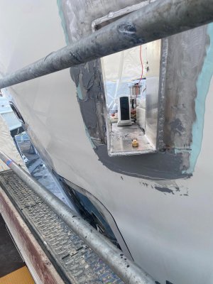

hello all, i might moving up from a sailboat with a spade anchor on a bow roller which served me very well up to 50 kn in the Meltemi arround greece to a trawler with two pool anchors in pockets. most yachts here in the Med using them but i very seldom see them using only one anchor and free anchoring at windy conditions so i wonder a bit. mostly they use both anchors and landlines , is this just a powerboat habbit or are the anchors to light to be used alone ? the steel trawler will have 70 ton with 2 x 65 kg and 13 mm chain. any real life experiences are highly wellcommed carsten
