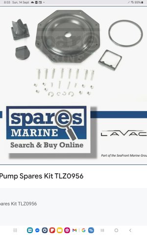

The two valves shown in the spares kit. The flap valve is on the inlet. The jocker type valve is on the discharge
You are showing the service kit for a Whale Mk5 bilge pump, which is the pump for a Lavac. The OP stated he had a complete lock up, which was exactly what I experienced. Clearing the blocked vent valve solved the problem. The lock up is due to the outlet being larger than the inlet and once the toilet bowl is full nothing will work.
The only other problem I have had with a Lavac was when the pump physically broke, the lever the handle moves had sheared. It never locked up, just kept moving but doing nothing. For speed I just replaced the 40 year old pump as I expected other aged plastic parts could suffer a similar fate.
In post #3 you said "There is no joker valve in a Lavac.", now you say the pump is for a Lavac ?
It is for a Lavac and it does show a Joker valve ?????
He says no such thing, he says the pump will not prime.
This is not correct. Vic describes what happens with blocked vents in post #12
That's because the pump pumps out of the bowl, which tries to create a vacuum (Lavac), this draws the flush water into the bowl. It matters not that the inlet and outlet are different sizes.
