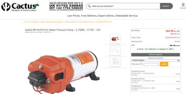

Shame the pump has tripled in price over the last 13 years. If I am correct a service kit is 100 quid!!
If you can get to the diaphgram, slather it in Vasalean, it's not a long term fix very much temporary but it will identify the problem before you put your hand in your pocket.
I have now discovered that my model of the Flojet is discontinued so I think I need a service kit!
MartynG that looks good value but doesn't match my existing spec and is ideal for use with an accumulator (expansion vessel) that I have.
