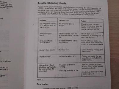

I have the Mk 8 version - see attached from manual.
If it is flashing red it appears that the back up batteries need replaced - hopefully the same for your version.
Mine has been removed from the boat and is available should you wish but worthwhile changing your batteries in the first instance.
