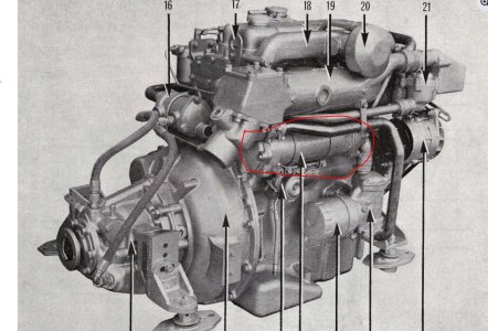

Here's a picture with the Heat Exchanger circled....
I have a similar engine. A few years ago I flushed and cleaned out the entire cooling system, including stripping, cleaning and re-sealing all three heat exchangers. Gearbox oil, sump oil, and coolant. The end caps are solid chunky bronze castings. I doubt very much if they have warped. Dismantling the heat exchangers often is not easy, because the mix of aluminium bodies, mild steel bolts, bronze caps and tubes plus salt water equals corrosion and seized bolts to contend with. If the exchanger is off the engine and you are able to get it apart, then as others have suggested, see if you can get the aluminium body repaired. If not, then consider whether your existing header tank and water-cooled manifold are in good order. If they are, it may be best to leave them in place. If they aint broke, why replace them? Some of the nuts and bolts holding them in place can be utter pigs to undo if those parts of the engine have not been worked on since it was installed. In fact, they may shear off, and need cutting or drilling out. Not easy with restricted access, and expensive if you have to pay somebody else to do it. So then, you could look either for a like for like replacement second hand heat exchanger from a dealer in secondhand marine engines. One in Dorset has been mentioned on the Forum previously. Or a new heat exchanger of suitable size, which could be mounted remotely and connected to the existing plumbing with new flexible pipework or hoses. Maybe slightly complicated plumbing: I seem to recall the thermostat by-pass has to be allowed for. A remotely mounted heat exchanger would have the additional benefit of allowing much improved access to the fuel lift pump and various coolant drain taps on the engine block.
Thanks for all your replies. We have already been in contact with the second hand dealer in Dorset but looks like no like for like replacement. We are going to attempt a repair next week with Hylomar and a new gasket and then Sikaflex if this doesn't work before deciding next steps. The end-cap is definitely warped by a mm! We have no idea how. Perhaps getting the end-cap skimmed might help if we can't seal the end? Our engineer has suggested a separate Heat Exchanger and recognises the complicated plumbing (although not sure about the thermostat bypass). Going to talk to Bowman in Birmingham on Monday as they are on holiday this week! Oh joy.
