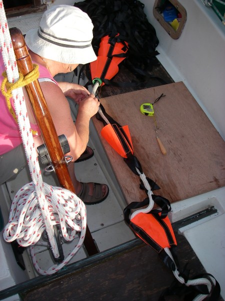

Re: series drogue
James,
As I type this Kathy is sitting in the cockpit of Fairwinds here in Madeira attaching cones to our series drogue.
It is most certainly not an expenasive device if you make it yourself. I got 110m of doublebraid nylon on Ebay for £100 and the 90 cones we calculated would be required for our weight of vessel came from Australia for just £90. Under £200 for something that could save our boat and our lives.
The drag device database and other sources seem to indicate that this is better for most vessels as an ultimate survival tool . . . less stress on the vessel than when held by the bows.
I sincerely hope that we never have to use it, and that I never get to report on its effectiveness here. This is the problem . . . I have yet to read a personal account on here of anyone who has lain to a series drogue.
Don't see why it would be less effective for cats - Richard Woods deployed a drogue from one quarter, recommendation is to deploy it from a bridle 2.5x the beam at the attachment point.
-Nick
