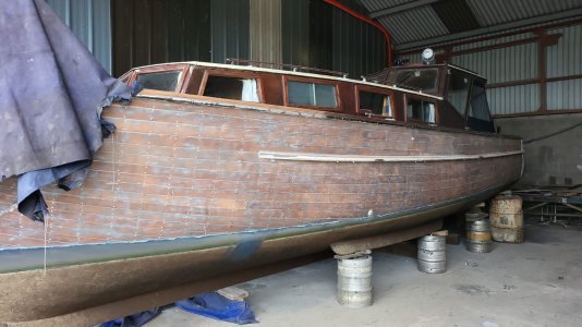

Basically what is the best paint to use on a carvel wooden (mahogony) hull that is 50+ years old. (freshwater) She is on inland (freshwater) waterways so not salt water. I realise that all paints will eventually crack along the seams but what is most likely to give the longest life before this happens? Currently Hempel 53840 has been suggested but data sheet says that this is recommended for steel? Hempel do another type which is for steel and wooden substrated.WS_stripped_2023.jpg Photo attached of her stripped back to bare wood. Thanks in advance for replies.

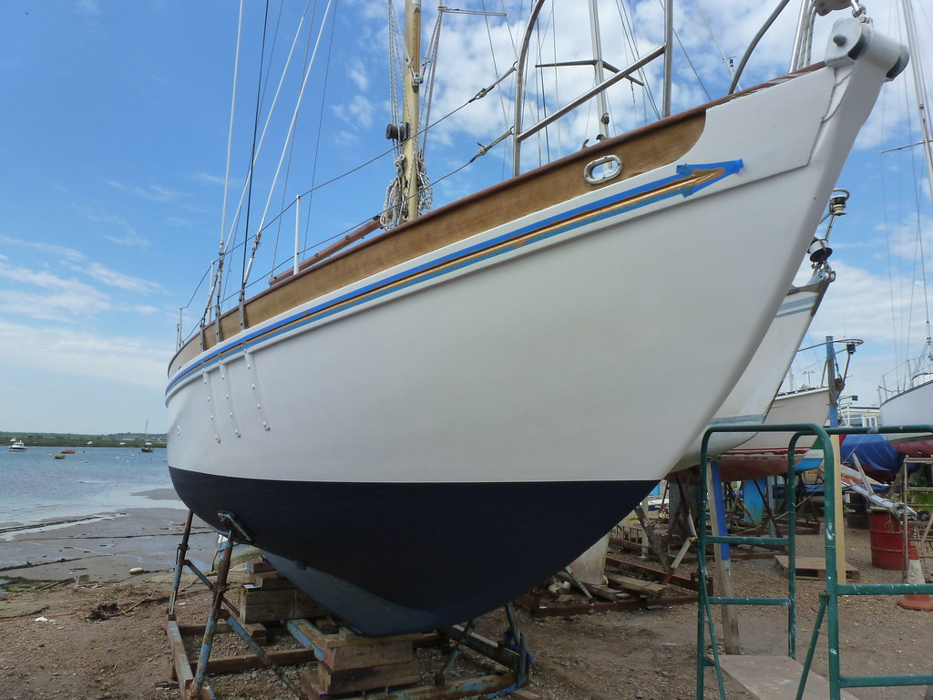

P1040887 by Roger Gaspar, on Flickr
Prime, undercoat, flatten, undercoat, flatten, gloss. Single pot not two pot and then you will not have any cracks unless there is a seam issue. If you get pouting, that is an indication of fresh water sealing from the deck. I agree the Multicoat should not be used.

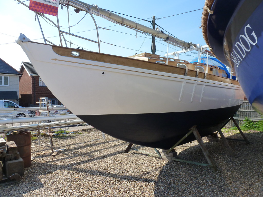

P1040211 by Roger Gaspar, on Flickr

What a lovely boat. And so well painted! what didi yo mean by pouting?
tillergirl
5 Nov 2002
8,380
West Mersea
Pouting is when you start seeing a seam 'bulging' outward. Bascially what is happening when fresh water is running down the inside of the hull, enters the cotton caulking which expands and pushes the cotton outward. 'Bulging' is a bit of an exaggeration. But looking at your image there is absolutely nothing wrong. With a sailing yacht one can get some small cracks in the topsides in the area of the chain plates (which of course you don't have) because the rigging constantly works. If you have a dark colour that is a different matter. A dark blue or black topsides would absorb the heat and dry the planking causing cracks.
You have a lovely craft there and well built boat.
