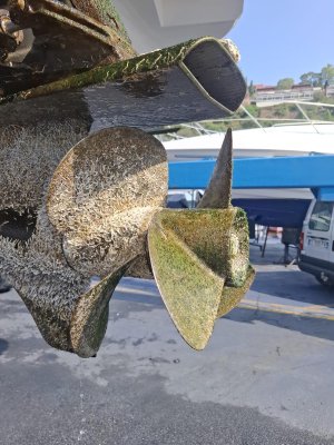

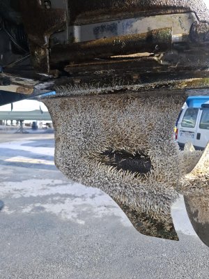

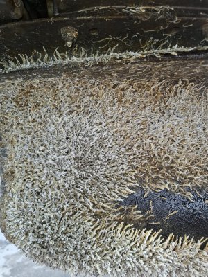

If your in chi marina I’d be checking the drive water intake for worm growth, is your engineer familiar with Volvo ?
Thanks Paul, yes in Chi marina, will check this out, engineer is familiar with Volvo, he is suggesting temp alarm sensor and clean out heat exchanger
