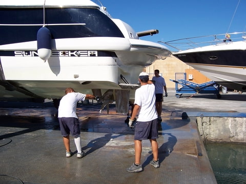

At last we found something to clean the drive's with, it's a acid wich we use to remove al of the barnecles... Sometimes I spend a day just to clean one drive and transom!
In Mallorca they use a toilet-acid (?). I had to survey a Camargue 50 and they used it on the props and shafts... it's called Aquafuerte..
In 5 min. time!
I could not believe my eyes... It ran straight back into the marina, no problem! If you try that in Holland you will be shot...
