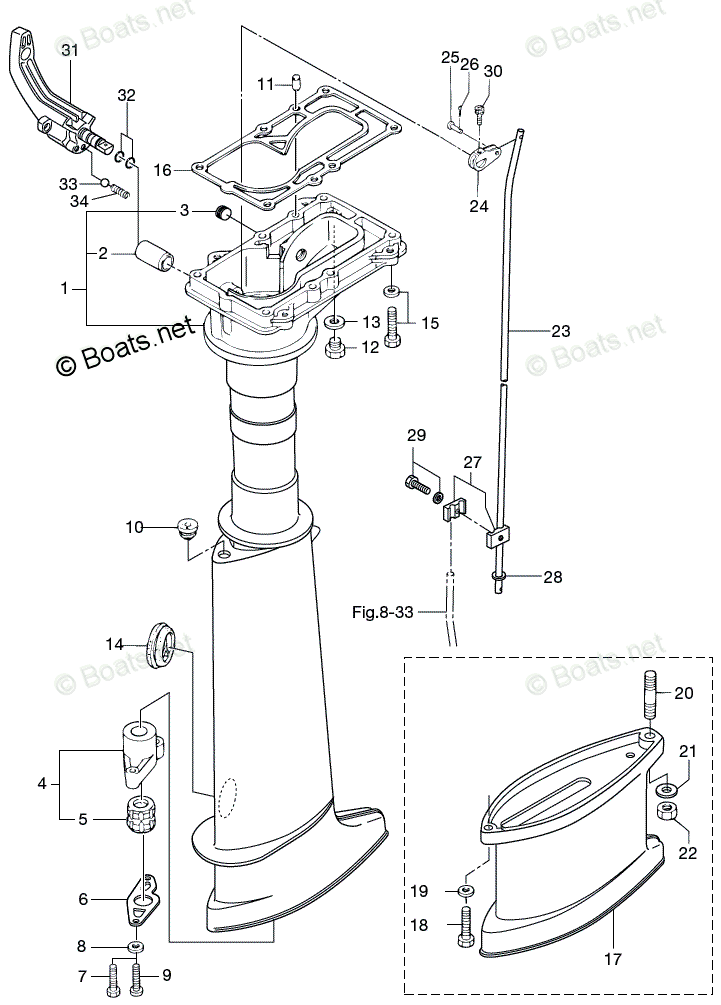

It he lever does not move then that is seized . Be careful not too much brute force or you will break it off. The O ring seals (#32) may prevent any release oil getting to where its needed . You may have to separate the power head from the exhaust housing
If the lever moves freely then most likely the clamp (#27) has come loose
You don't say what year but this diagram is typical
https://cdn.boats.net/cdn-cgi/image/quality=50/MTA/d/f/MjEwOTQ5-fb048094.png
