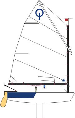

On the gooseneck- you currently presumably have something resembling a C with a rod that does into the boom so something like this: ---C
There will already be holes in the gooseneck as part of the standard rigging: ox36bjm3-optimax-binneneind-voor-40mm-giek.jpg
Are you using them?
I'd be tempted to do something like this:
with Shock cord for the blue. Will allow the boom to be lifted up parallel with the mast... If set right the C clip holds it to the mast under normal conditions with the Vang doing its job to help keep it there. Then When she comes back ashore, vang off, lift boom by hand C will pop off the mast but the shock cord keeps it close so there is no flying boom...
If you aren't using the holes already there check out: http://www.optistuff.com/info/faq/manuals/OptimistBasicRigging101.pdf (Look at the "Bling" ) Because I think you could probably do a bit of hibrid of both to make it slightly easier to "fold" the boom
My recollection is that optimist goosenecks do not really clip onto the mast at the best of times, being barely more than half a circle. Thus the only issue with raising the boom is that it could fall out of alignment, making lowering difficult. Could you fit a couple of plates to the front end of the boom which keep it aligned as you raise it to vertical? A google search for "Mirror dinghy gaff jaws" shows the required shape. These plates would not be an issue when sailing, and if merely clamped around the boom (with a couple of long bolts) would be fully demountable (to allow for further tinkering).
