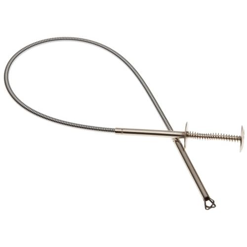

I have one of the grabber tool things:
These are good for getting the mousing lines out of the sheaves at the bottom of the mast. (amongst many other jobs on board!)
