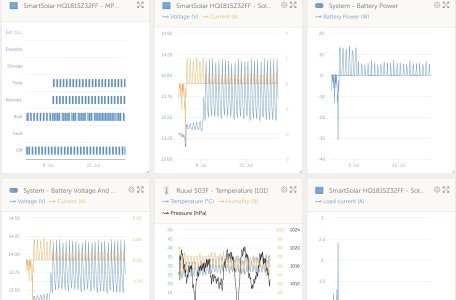

The Solar will charge the LP batteries anyway so you will not have solved your primary problem. You could rig a remote switch through a VRM such as the victron global link which has a remotely operated rely.
I decided not to do this and my 50w solar fully charged my house bank in a few days and is currently cycling each day. I will put a relay in next time I go to the boat.
