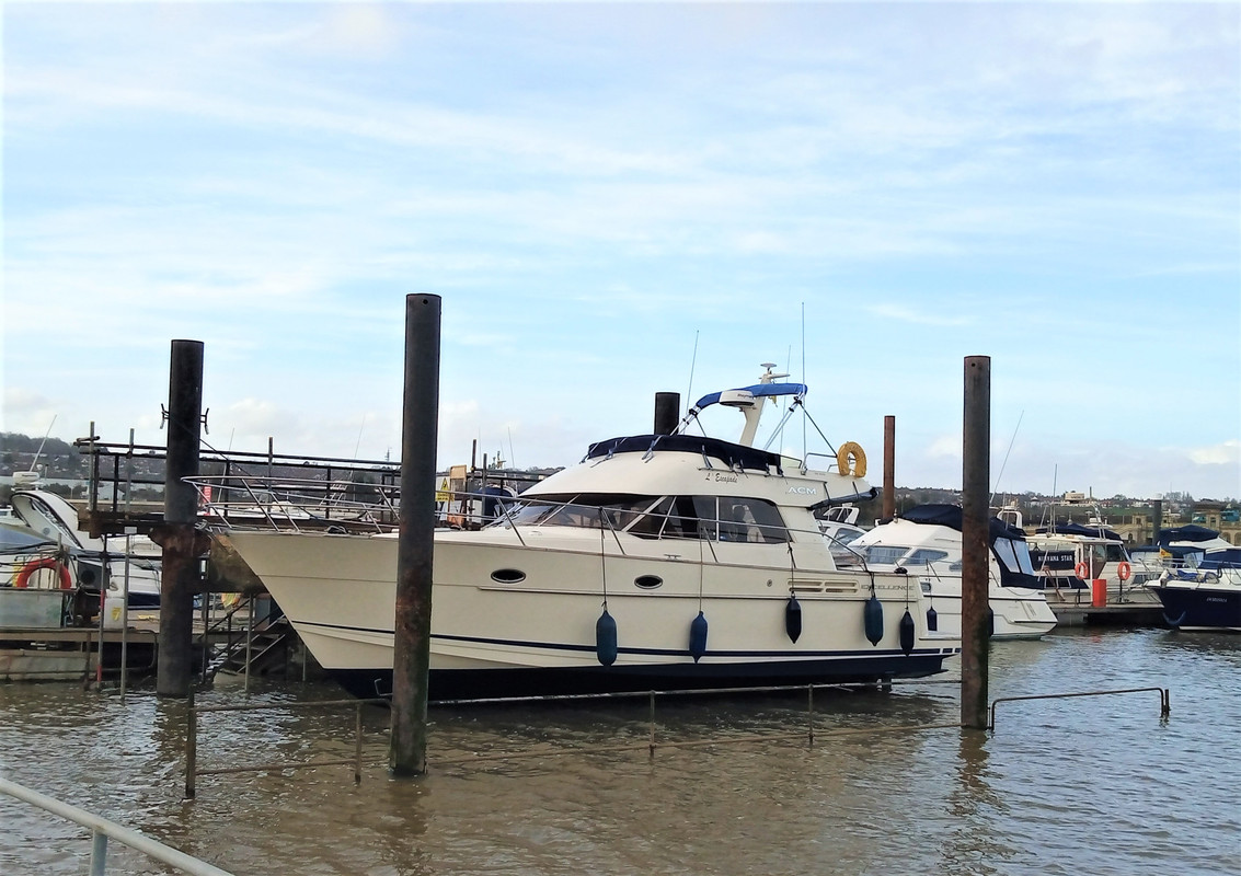

This Thursday. HW 07.30 BST.
Jetwash.Anodes and A/F and quick lick of Oxalic.
Possibly 17C.
Time to find the special "Bobble Hat" with the multi coloured splatters of previous A/F attempts.
How goes the day.
06.00 down to boat for 07.30 HW.
Strong westerly.
07.00 tide decides it not worth the effort and starts to ebb.
Boat on blocks with a couple of feet to spare.
Jetwash off.
Loads of slime with the odd barncule.
Shaft anodes gone.
Both rudder blade anodes gone.
Main 4 Kilo anode and both trim tab anodes 50% gone.
Prop nut anodes virtually gone.
While waiting to hull to dry, apply Oxalic Acid.
OGs receipe.
O. acid. £13.00 from Ebay.
250 grammes of crystals
Half small bottle of Fairy liquid.
Bucket of warm water .
Apply with soft broom and wait, couple of applications on sink outlets etc.
Cleaned up the hull 100% almost as impressive as a full cut back and polish.
Apply A/F and wait and wait.
Eventually we do float off the blocks , then some interesting gyrations going astern as the tide and wind make life as difficult as possible,
