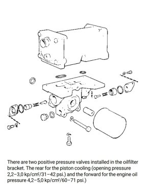

Beyond senders for alarm and gauge also consider to check pressure by a known good gauge and (snip from a 40-series handbook):
