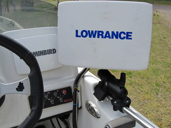

I helped a mate with the cupholder idea a few years ago, and it did work perfectly.
We used Polymorph and moulded a Ram mount into it, then purchased the relevant Ram fittings to adapt to his (Hummingbird) fishfinder.
The Polymorh moulding ensured a perfect fit into the cupholder, and didn't bounce around at all.
Link here to Polymorph
I would also just drill the small mounting holes for the bracket (I assume?). You are either going to leave the plotter installed/mounted-so you can't see the holes anyway, or remove the plotter and leave the bracket- in which case, same situation !
