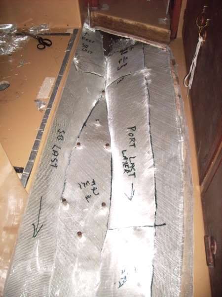

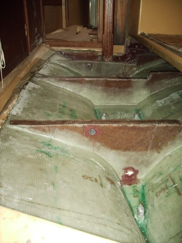

I love my Fulmar dearly but I'm constantly coming across examples of shoddy workmanship.The latest one was today when I noticed that of the eleven bolts two have fiberglass plates under the nuts.All the others are 5mm stainless.It is obvious that they ran out of stainless for the washers and used what was handy.I'm probably lucky it was fiberglass,imagine they had some cardboard lying around...
The keel is still solidly in place but that doesn't make it right.
And there's more,like furniture glassed under fittings(stanchion base) a mast post that wasn't cut straight on top(had to remove the mast and rebuild), ridiculous puny floors that broke as soon as the boat was laid on the keel,etc ,etc.
Still it's a great boat and everytime I'm out there I forget all that.
