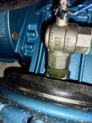

I bought a 1976 Trapper 500 this year - Oystercatcher. It is fitted with a 2009 Nanni 2.14 engine and sail drive.
There is no raw water strainer fitted between the raw water inlet valve on the sail drive (see image) and the raw water pump. I have a new raw water strainer ready to fit, but before I do so, I'd like to know of there is any good reason why there is no raw water strainer fitted before I fit it?
Any thoughts, advice would be appreciated.

No good reason. There should be a strainer between the inlet valve and water pump.
