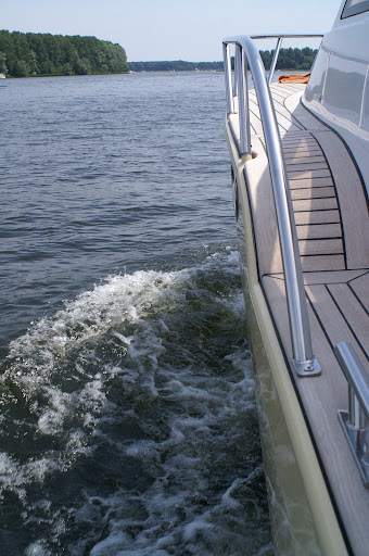

Looks interesting. Yep, would need to drive it to see the forward viz -looks borderline. Not bad looking boat though and in many respects a very nice interior. The light wood might be sycamore, can't tell, but looks nice. They have made some awful errors on the detailing though - side decks with no toerail, a disastrous caulking pattern in the teak (parallel planks on the fordeck, urgh) and a stanchion base with a screw showing and the plate not quite mating right with the teak- niiiice. Also the stanchion bases further forward look a bit iffy - painted in hull colour? Teak deck scooped out around them? Would need to see close up. Such a shame to take the edge off the product with these sorts of things.
