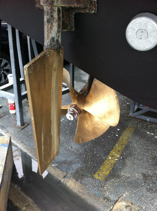

I've just had a new prop delivered but before I fit it i thought I'd ask for advice on how best to protect it.
We bought the boat last year, a Nimbus 3003, single shaft and bronze prop. I noted that when we viewed her the hard an anode wasn't fitted (the trim tabs however each had one fitted). I asked for these to be replaced and a prop anode fitted prior to the sea trial as I didn't want to have to re-lift if all went well. Fast forward to launch day I noticed there was no anode on the prop or shaft, but the Brokers Engineer tried to reassure me that one wasn't needed, I thought this was rather odd but as there wasn't any evidence of one being fitted I reluctantly went ahead with the sea trial. In April I had a lift out for a wash off and noticed the prop was in pretty poor condition and hastily fitted a shaft anode in an attempt to stop it getting worse. I'm rambling...
So I've looked at pictures from when the boat was out of the water and can't see a tapped hole in the shaft to hold a cone anode, I don't want a shaft anode if I can help it. Is there another proven way of protecting my stern gear that wouldn't involve a shaft or cone anode ? A link to the trim tab anodes perhaps?
