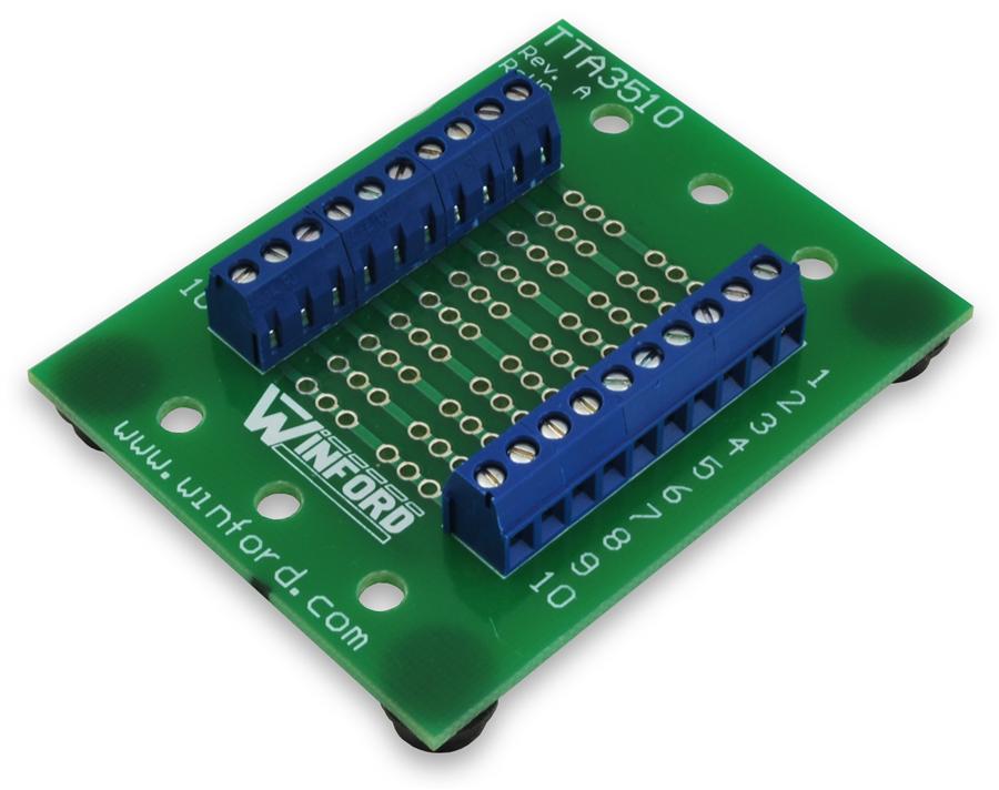

I've finally got round to replacing the rats nest of wires connecting my various bits of NMEA kit. This is the box that will now live in the chart table:
It has dedicated terminals for: CP180, a 3-way switch to the CP180 input port, HP-33A AIS, ST60 Graphics, GX2100E VHF, and six USB ports (housed in the box on the right, along with a USB hub).
I've started wiring the interconnections, but it's going to be tedious to keep the wiring neat. I wonder if it would actually be better to have loose wires, so the connections can be followed. Opinions?
Also, any thoughts on how best to create a NMEA GND bus?
