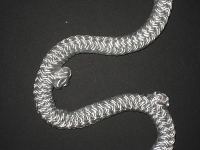

Liros is right. You should NEVER wash a new rope in a machine. This happens quite frequently, as the attached image shows. Wash it by hand (if at all--it didn't really need washed) for the first few years, and then wash it in a bag. Or take your chances. The steady motion of the machine does it by milking the core relative to the cover.
https://3.bp.blogspot.com/-QUMhJvwL...M/-yvxIaoN7Es/s400/herniated+rope+low+res.jpg
The reason they do this is that the cover is left somewhat loose for easier splicing. You can't have it both ways.

I worked on a rope wash research project with one of the rope manufacturers. The herniated rope pic I posted was from that project.
* Often detergent and high temps won't hurt the fiber, anymore than they will polyester clothing. However, they will remove the spinning lubes, which will make the rope a little stiffer and prone to squeaking. It can also increase internal wear. However, the lubes are generally gone by year 3, so detergent is only a problem the first few years.
* It's not the spin cycle, it is the steady milking back and forth during the wash cycle. This varies from machine to machine, but it can be like what you do when TRYING to get the core to pop out of the rope with a fid during the splicing process.
The most important step is actually a long pre-soak in a bucket, in my testing.
