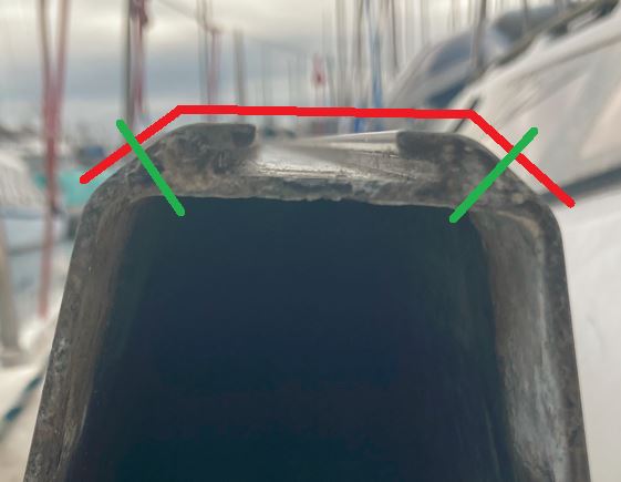

The bracket would need to curve (in red) to cover enough 'meat' to rivet into (in green!).

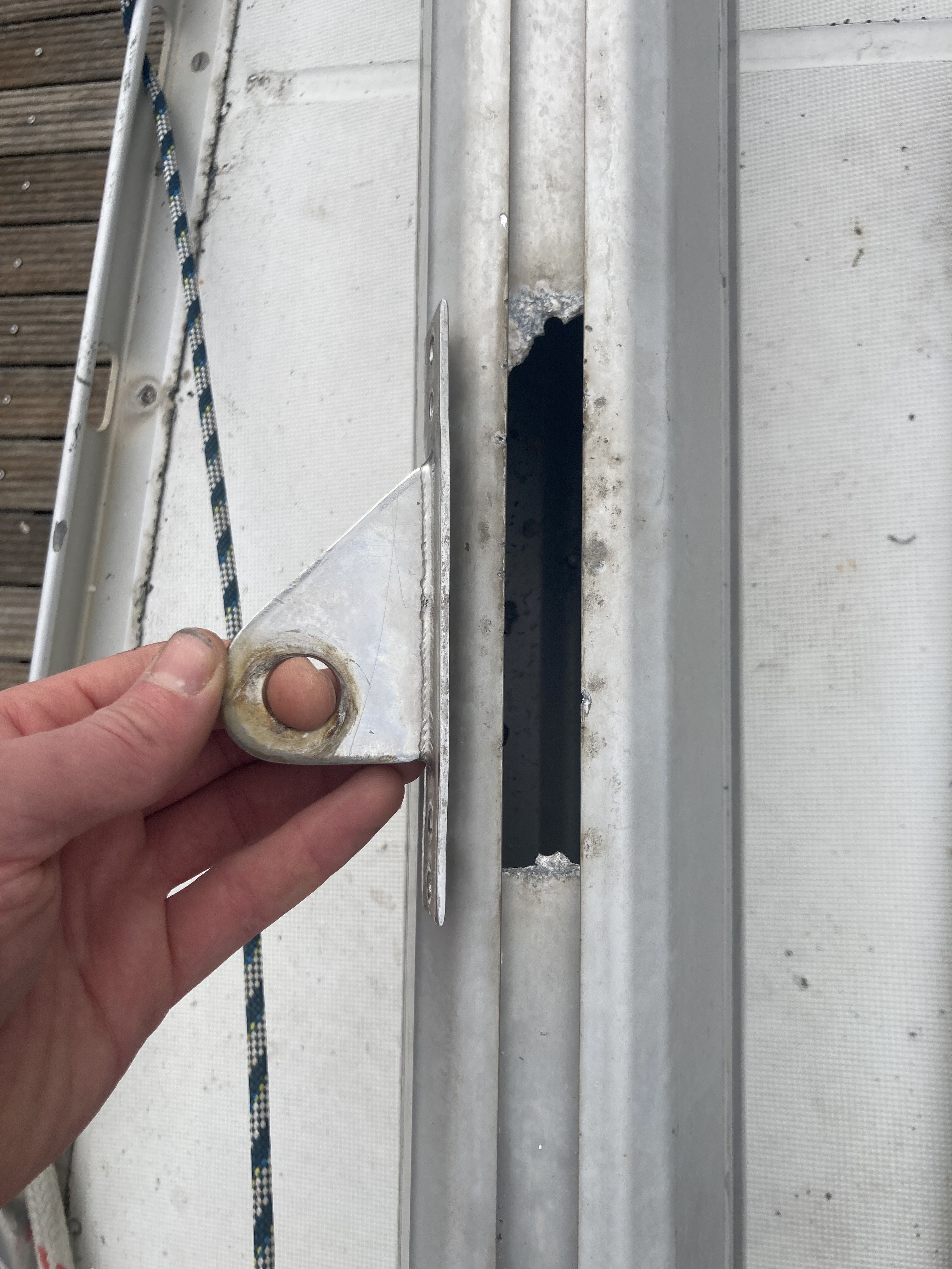

More photographic evidence -

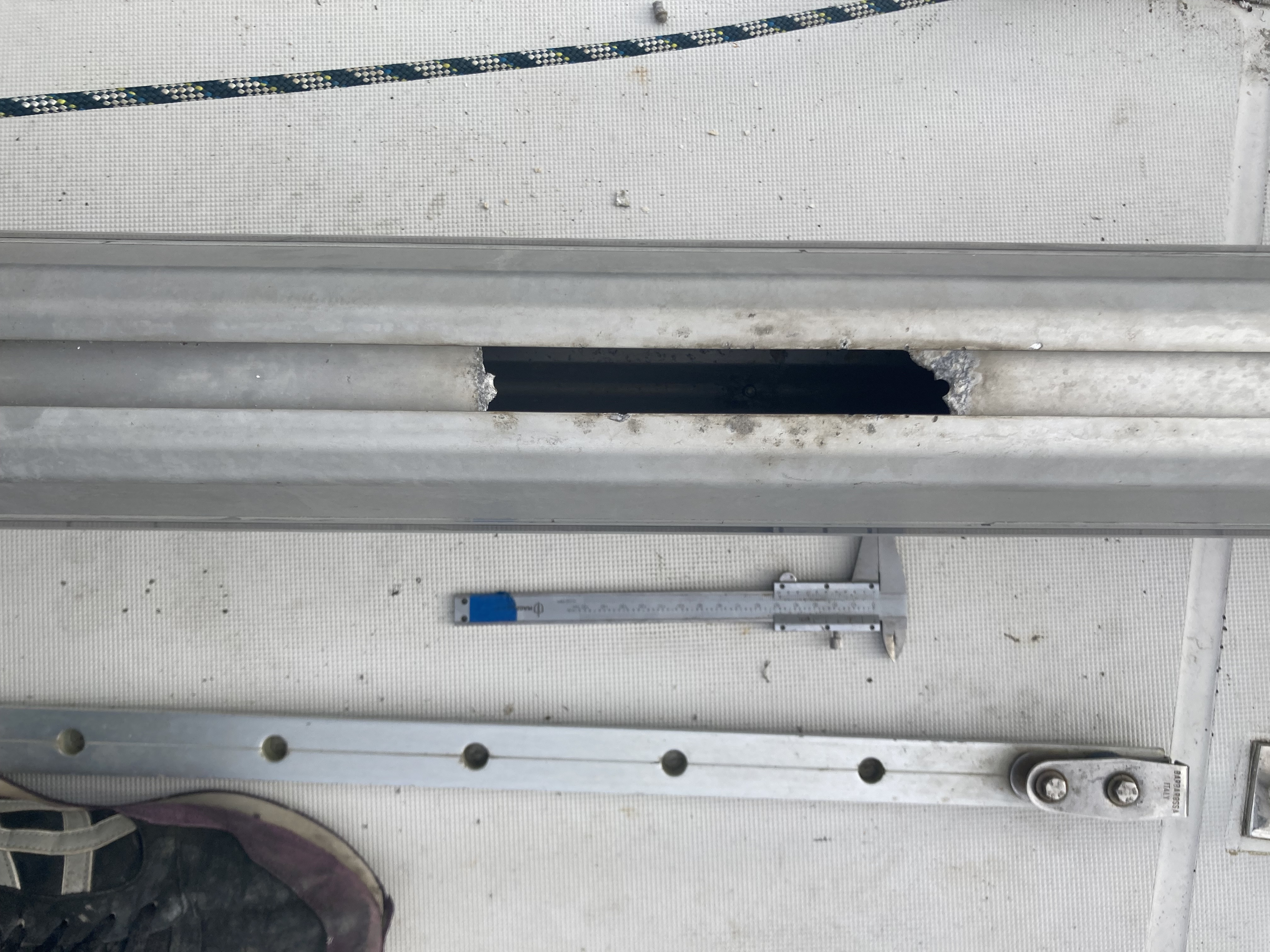

Offending hole:
The vang bracket shown next to its hole - the bracket itself pre-dates the sort of 'rod kicker' vang we're fitting and so would need to be beefed-up or replaced anyway:

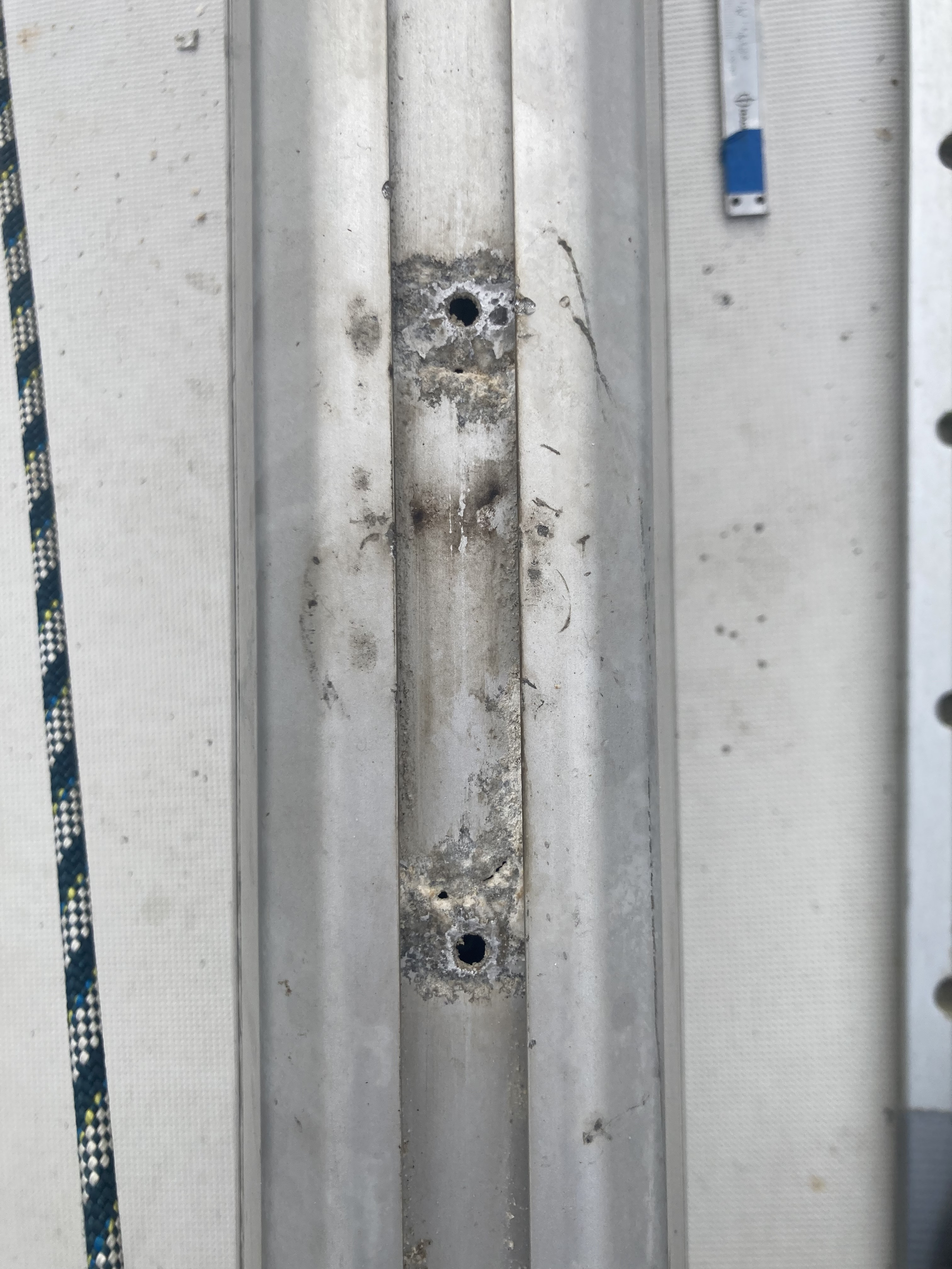

Close-up of the hole. Presumably it could be patched (e.g. piece 3mm x 30mm flat) and welded. I was even thinking I could practice my brazing skills with repair rods (assuming no direct load would go through the repair piece):

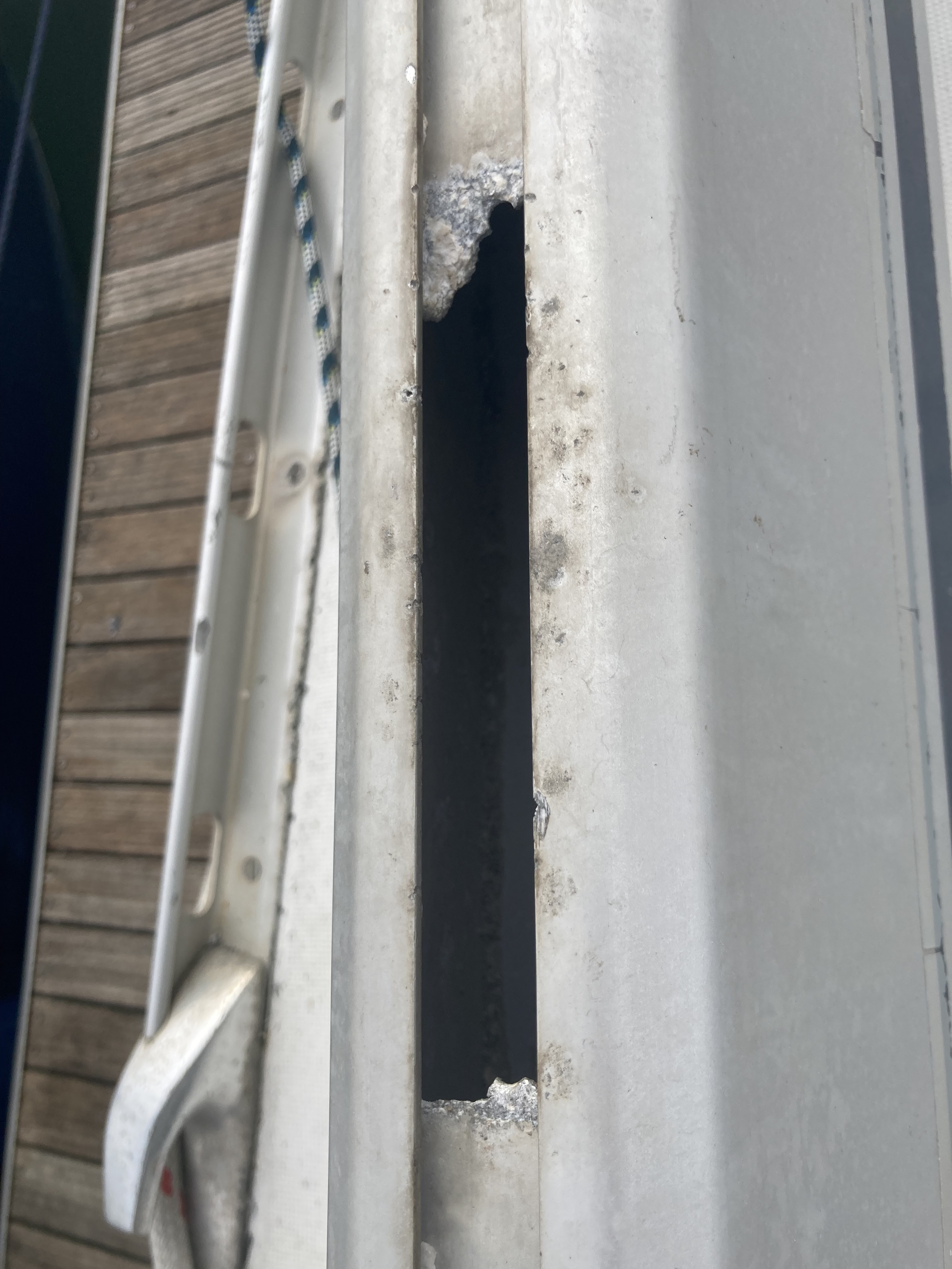

This is the worse area under one of the mainsheet bales. It's well on its way to the same fate too:
Offending hole:
We snapped our boom at the vang connection point several years ago. We had it externally plated with 6mm plate. A new vang bracket was welded on in 10mm plate. Stronger than the original.
A large plate folded to the profile of your boom and riveted in place with 6mm rivets would solve your problem for not much money. Weld on new heavy duty vang mount and you are back in business

If you plate the boom as I suggested you will be fixing to the plate not the boom.
Yup if I plate then as per the image posted above - the red (plate) would have the bracket for the vang welded to it and be riveted along the green lines with 6mm monels.

I might also make similar plates to mount the bales (mainsheet attachment eyes). There's a very good local place that only does bending (sheet, tube, bar etc.) and so I could get them to make up a series of bent plates (or a long one that I chop up). I think forming those the bends neatly would be beyond me, even in 3mm.

Our plate is two foot long. It has a double row of 6mm rivets. 24 on each side of the boom. I would wrap the plate around the sides or the boom as well. You want it strong. That way you could get a row of 12 rivets where your green marks are and another row along the sides of the boom. If you have time, get the plate anodised before you fit it
