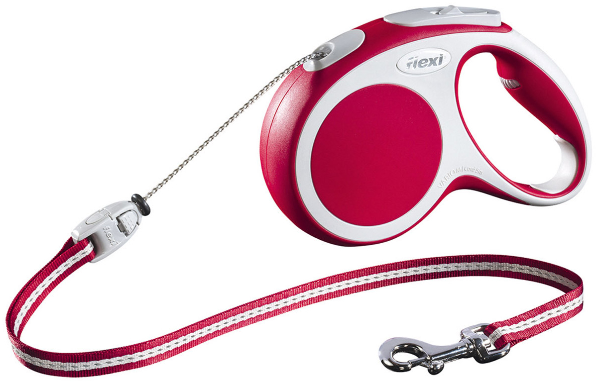

Or go for the cheap option and buy one of these and a small buoy... ;)
