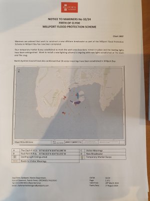

The new harbour breakwater at Millport on the Isle of Cumbrae appears to be completed. Although we have not yet visited this year, reports suggest that the moorings have been reinstalled for the new season. This fairly significant development in a busy harbour doesn’t appear to have been recognised yet on my Navionics App. It got me wondering just how responsive the Navionics charts are. I get frequent messages telling me my charts “are old” and require “updating” virtually every day on the App and I dutifully press the update button on the assumption that I then have the most up to date charts possible. However, the Millport breakwater is not marked on my charts; should I expect it to be there?
I guess there is a formal process for altering charts; this just seems a bit slow. Can anyone help?

Not seen a notification that work is complete, but the CNTM that detailed the restrictions whilst works ongoing is no longer in force.
Looking to visit at some stage soonish just out of curiosity, planning to enter from West and avoid any large floating object. Wondering if breakwater will reduce any residual SWly swell if wind has been blowing that way...
