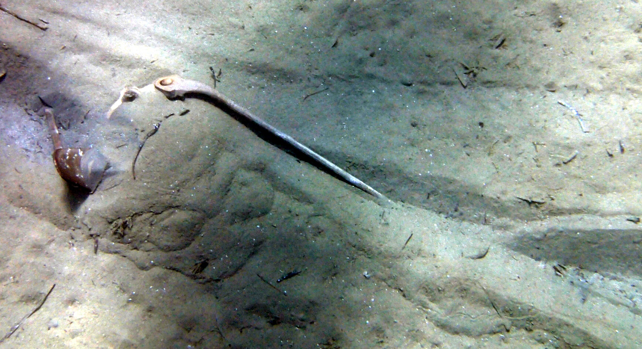

The odd thing about CQRs is that they can hold well but they do not seem to behave as their literature says they do. This photograph was taken during winds of about force 6. The anchor held the boat and did so overnight during very boisterous conditions. What it did not do is rotate, finishing up with the shank on the surface at 90 degrees to where it is here, with both faces of the plough buried. I have dived on very many CQRs and have never seen one that was vertical rather than horizontal as shown here.
