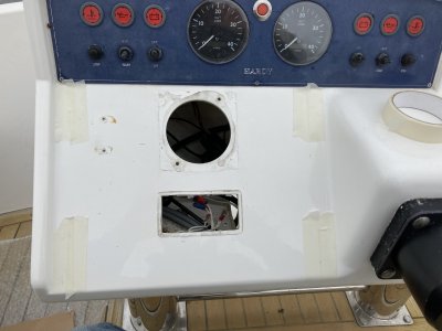

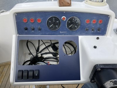

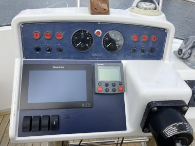

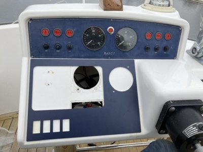

Perhaps not the most inexpensive route but we have had several panels made by Brian Wards of Brundall to cover various issues / mount new kit. They have a range of materials and will make up what you need to your specification. They have supplied a lot for local boat builders over the years including Brooms, Haines and Hardy.
The most recent items we have had have been a small panel to mount the new Webasto heating controller and cover the holes/marks from the previous Eberspacher unit and panels to mount new electronic engine controls in the space previously occupied by Morse controls. A couple of years ago they did a panel for the flybridge when we installed a plotter and as they did the original Hardy’s they still had some of the same blue material in their storeroom - still need to replace the upper panel as it looks aged in comparison 😉

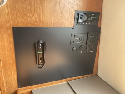

Another plain black panel that Brian Wards made for us to rectify some fairly messy mounting of kit by the previous owner and to facilitate installing a new Fusion music system in a slightly different location to the previous kit and to install a TV.

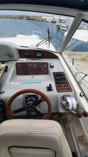

I replaced the dash panels on my Broom Ocean 38 last year. I got a local company to CNC cut it from a cad drawing I did.
