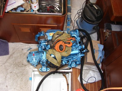

This has just replaced my 4107 perkins
Good job.
Also re-engined two years ago.
This little baby replaced the original Vetus
Why didnt you go with Vetus again?
Price mainly - I got a very good deal from Nanni (through Fox's)
Practical reasons too:
- Previous Vetus was Peugeot based - current Vetus are Mitsubishi based. Previous engine was 50hp, wanted to trade up to at least 60hp. Strangely enough, more adaptations would have been required to fit the Vetus.
- Spoke to several Nanni owners - all were very pleased with the Nanni.
So, the Nanni came recommended, was substantially cheaper and required less work to fit.
