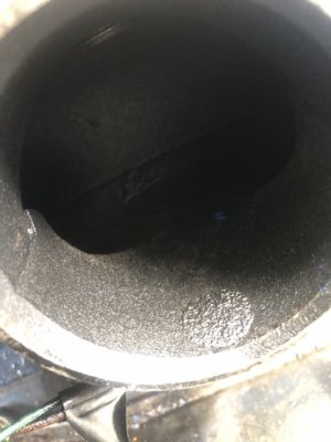

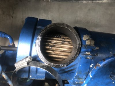

I’m out on the boat just now. I’ve taken the crossover pipe off from between the CAC and the inlet manifold. No sign of any water or corrosion, just a light film of oil. Looking into the CAC via its outlet, the tube stack looks in good Nick, with a light coating of oil. Second pic is the inlet manifold.IMG_3539.jpegIMG_3540.jpeg
