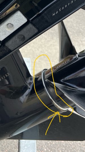

got another "tip" from a youtube video from Reel Life Fisherman, see below image, the white plastic ring have something to do with the exhaust and when it gets worn out you can lose top speed/rpm. so might try changing this when replacing prop with stainless ( probably after season)
