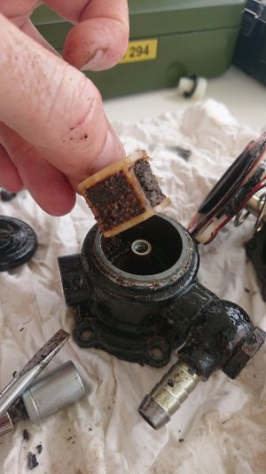

Well I think I have found the cause...
Didn't know there was a mini filter in there. Not even sure how the engine ran at all!
The rubber diaphragm, after cleaning, also looks like it's starting to deteriorate. €70 for a new pump, so it's been ordered.

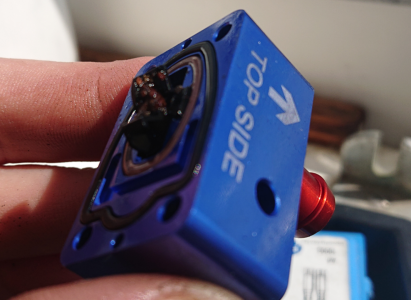

Just an update for future reference - this semi-sorted the problem. Another sea trial and it was still behaving in the same manner, but able to maintain 2200rpm before power loss kicked in.
I'd forgotten totally about the fuel flow sensor. Return line sensor was of course fine, supply line however :
Photo doesn't do it justice, there was a sizeable lump of crud in there.
Yet another sea trial today and it's good again. I'll need to get inside this fuel tank though, at some stage. Eep.
