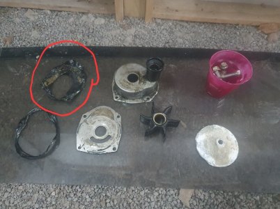

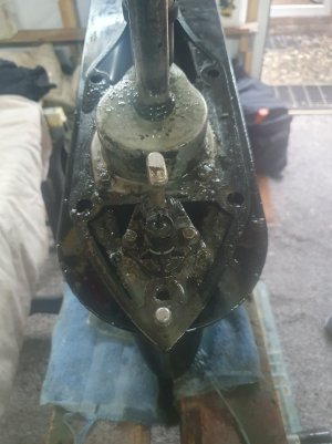

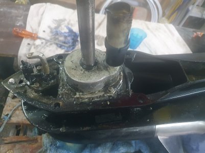

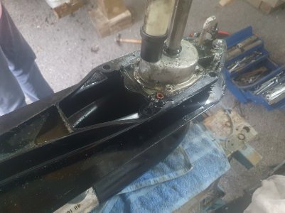

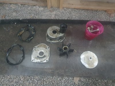

I took it apart tonight. Interested in what the experts think.

Sorry pictures seem to be in reverse order. My mistake.
Spannerman are you saying this is the seal under the water pump base plate that is probably leaking?Screenshot_20250716_215604_Gallery.jpg
