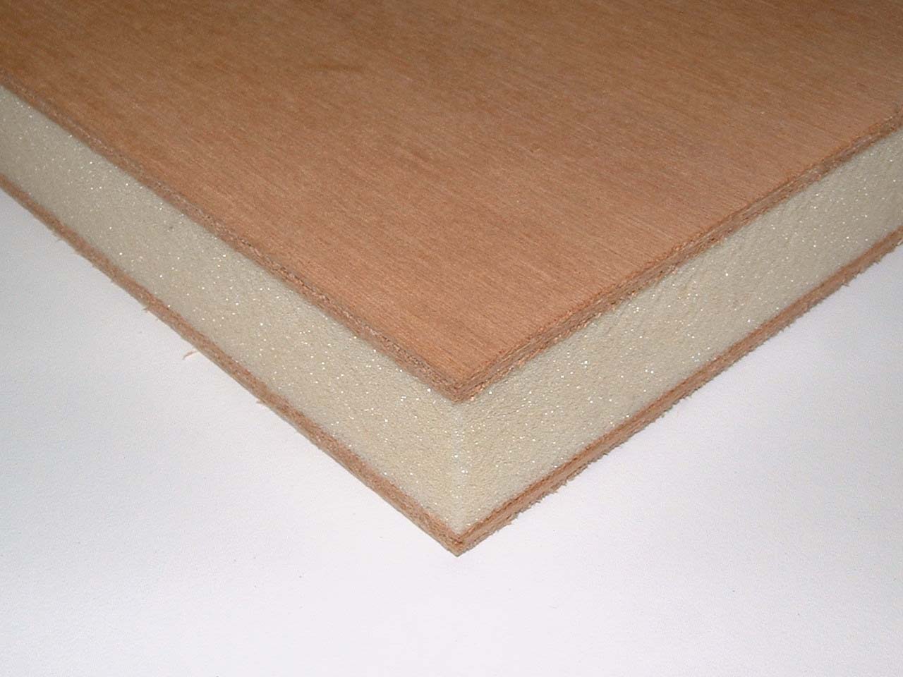

I have foam cored plywood for interior panels. I imagine it's more capable of taking a soaking than MDF, but at $400 a sheet for 8' x 4', I would hope so too!
Oops! It's a bit of a big pic. Didn't look like that when I copied the link.
