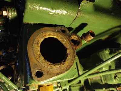

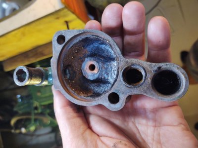

I understand that I may need to block a bypass opening for the flush, I am not sure what opening this is. I have attached pictures of the thermostat housing and exhaust manifold where it attaches, can someone please point out the hole I need to plug for the flush.

The bypass is the small hole just to the left of the copper pipe which connects to the thermostat housing. The hole in the housing with the rubber o ring lines up with it.
I have experienced the by pass itself becoming blocked so no cooling water flows until the thermostat opens. It might be worth trying to clean the bypass with a bit of wire. You could also run your flushing pump with the closed thermostat in place.
The thermostat housing looks to be in good condition. Look after it because it is worth its weight in gold!!

The bypass passage which ideally you will need to block is in the thermostat housing between the top and bottom connections. I do not know how practical it is to block that.
