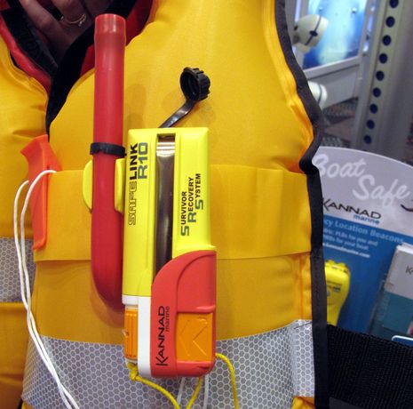

This image you included above is NOT designed for sailing or cruising it is the diving version of the AIS Fastfind and will withstand submerging to 70 metres and can be operated with diving gloves. It is for a diver who loses sight of his buddy and gets carried away from the Dive Boat. He can then twist the base and he can accurately alert the dive boat of his location.
The Sailing version is somewhat different and is installed inside an inflatable Life Jacket. The LJ version is water submersible to 3 metres (see image below).
This is the unit for sailing as it fits to the life jacket
They do not transmit on 406MHz and therefore you will not wait for a satellite, then MRCC Falmouth, then the SAR assets.
It transmits on 162MHz and all chart plotters, within range, with AIS will receive the 970/972 MMSI code as a MOB with bearing and range with an alarm sounding.

If you are thinking of using one for other than its designed use, it will not transmit the correct details as it is not a 23*xxxxxxx MMSI code but a 970 or 972 MMSI code which is probably burnt into an eEPROM.
It sends an MOB alarm code and not an AIS ship code and on my screen come up as a white cross on a red circular background, similar size to the AIS icon, with an alarm sounding and a 3 centimetre grey bar across the bottom of the CP with full details including Lat-Long, bearing, range and time.
Could equally be used by someone who goes overboard, assuming the boat has an AIS receiver.
It is far more clunky and quite a bit larger than the yachty one which is similar in size and shape to a double tampon carrier.
The Dive (McMurdo S10) one is circular 8" x 2" and slightly tapered, the LJ version (McMurdo R10) is 5" x 1½" x ½".
I have both onboard as I have full SCUBA diving gear if ever you are down this way you can take a look at both units side by side?

Personally I reckon they (preferably the smaller yachtie version, not the chunky diving one) are the best choice of electronics for man-overboard use for anybody except single-handers. The nearest people able to help you are the rest of the crew on your boat. It's them you need to alert and broadcast your position to, and that's exactly what an AIS SART like this does. You will pop up on the plotter screen immediately, position updated every few seconds. Calling out lifeboats etc can be done by the yacht crew using DSC (or the boat's own PLB / EPIRB if required) - but more importantly they can get back to you without any outside assistance. That's a lot better than you calling direct to the MRCC with a beacon that takes a couple of minutes to send its first shout and then only updates relatively infrequently - and leaves your crew out of the loop entirely.
Pete
Absolutely Pete, the 406 EPIRB signal can take 45 minutes to an hour and a half before any SAR units are called out as there has to be a satellite "in view" and the signal has then to be down-linked to an earth station and then on to the MRCC before any rescue can be even started. This is time you do not have with a MOB.
As you quite rightly point out, using a McMurdo R10, you can initially keep the rescue "in house" and start immediately and not have to wait around, by all means call out the Big Yellow Paraffin Budgie (Grey and Red now) if needed. - It's a complete no brainer!! ;)
