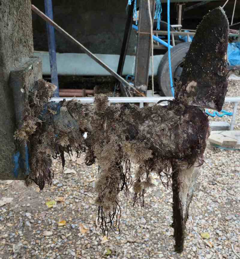

Mine looked like that after copper grease and lanolin!
I have a brand new folding prop and figured that to keep it as slippery as possible might do the trick!
Has anyone tried varnish/lacquer?
If not will try Trilux with heavy heart!
