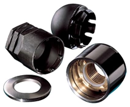

When we bough our boat, it was fitted with a High Five SS prop. We don't really use the boat for watersports - rather just cruising around a bit, and so have wanted to change it for some time. As we've had a few issues with the boat, and been keen to use it as much as possible the last couple of years, buying a new prop has never found its way to the top of the 'to do' list... until now.
Anyway, since the last owner kept the boat on a river, he'd fitted a McGard Prop Lock, so that the SS prop didn't grow legs and disappear. When we bought the boat, we were told the 'key' for this had been lost... which was fine, as, to me, anti-tamper devices never stop me (they may as well be called 'come-and-have-a-tamper' devices! I was going to get my dad to have a go at it, as he's got a lathe / milling machine in his garage that he spends too much time tinkering with, but as I was at theirs over this Christmas period, I'd have a go myself! Well, five hours later, I've made a key and the prop is off!!
The question I was going to ask though, is, is it normal that the McGard Prop Locks have no form of anti-rotation device fitted? It's just that I know normal prop nuts usually have a tab washer or something to help prevent the nut backing itself off, but this prop lock was just a free spinning nut that was only in place by virtue of the fact it was tightened up good'n tight.
I was planning on staying with the Prop Lock, but now given the lack of anti-rotation (not that it should undo itself if torqued up properly) I may just use a normal nut/tab washer with our new prop. Security isn't really an issue, as we're in a drystack in the summer and on the drive outside our house in the winter - but you never can be 'too secure', as I see it!

On the Mc Gard locking prop nut when you take it off there should have been a dished type washer behind it for the nut to sit on. The centre of the nut sits in this which allows the outer collar to spin

Ah ha! That definitely was not present on ours! That said, the ourter collar did still spin? If I recall, though, the forwardmost part of the prop's hub had a slight raised section that the nut tightened onto, meaning the outer collar could spin.
