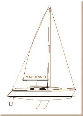

My Dufour 30 is described as having a masthead rig, however I have been told it is rigged as a fractional? I think the person is saying this because it has a large mainsail, small foresail, single swept back spreaders. Both the cap shrouds and lower shrouds afix to the same point on deck and it has a backstay (no running backstay), only one forestay (no babystay) . The reason I ask the question is I have to tune the rig and according to the book I am reading the amount of tension requires varies between the two types of rig!

If it's this Dufour 30 (Classic), it's masthead:
