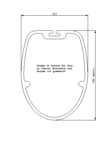

A long shot I know, but anyone know what this section is? We have not take the shoe off. Its from a Dehler 38. Anyone know who would stock some of this?
John
I have been told that some of the Dehlers like mine late 80's early 90's have dehler section. They bought the stock and used it for various models ie 31,32 and 34 ft, I think the later ones were Selden.
The outside dimensions are similar to the Sparcraft S330 section.Although the outline shape is not the same.
Try here
Sparcraft
It would appear to be an older section as most modern mast sections which are 160 mm have a width of aprox 105 mm.
