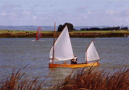

Ha, Smiffy
No probs at all! Yep, Beth is a hoot! But I would say that, wouldn't I?
A spar guage came in terribly useful as you can see from this pic. Those were the first round wooden spars I ever made. Some time ago now!
