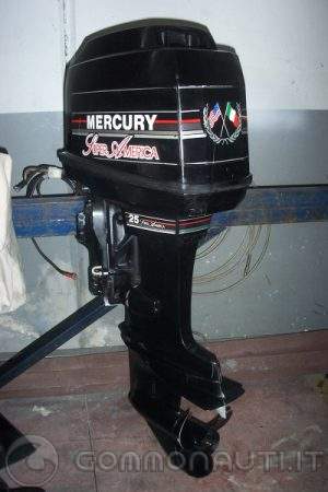

Isn't it the one which was also labeled as "Super America"?
That's what I had on my very first boat, it survived my initial MoBo (and also waterski!) approaches, which tells a lot about its reliability... :)

That's an unusual animal MapisM. It was sold as the 40 generally, but detuned and badged "SuperAmerica" only for the IT market, presumably by the IT importer (who just stuck a decal on I think...). I have no idea but I guess the name "superamerica" has cachet in IT, seeing that Riva of course used it for their ultra-desireable big flybridge boats of same era (?)
Anyway I think the 40/25 was a much later design, with 4cyl power head made by one of the eastern JVs (Tohatsu or Yam). The engine Mavric has is the "classic" 4 cyl 50hp made and designed in Wisconsin (and later, made in Belgium). Different engine

Aha, I see. Yep, I knew that this version was detuned for the IT market - in fact there's also a "25" label in the pic, because in those days the regulation allowed to helm boats up to 25hp with no license.
But it was also a 4 cyl, and after the removal of the obstruction in the intake manifold it also became a 50hp actually, not a 40. Well, that's what I was told, anyway.
Hence my thought that it could be the same beast. But coming to think of it, it was 700cc or so, IIRC. So, yep, different animal.
As an aside, I'm not sure why that name was so popular, to the point of being used by Riva, as you said.
Back in those days, if anything they were the IT boats to have a cachet in the US, rather than the other way round...

The Merc/Mariner 4 cylinder ( 500/50hp/45hp ) is 721cc, so may be the same unit ?

Doh! You called the one bought by Mavric "Merc 500 50hp" in your previous post, so I assumed it was 500cc...
That's why I ruled out the similarity, in my previous post.
Now, I'm pretty sure mine was 4 cil and 7 hundreds something, but can't remember if it was exactly 721.
Oh well, no big deal anyway, that's not going to make any difference for the OP!
