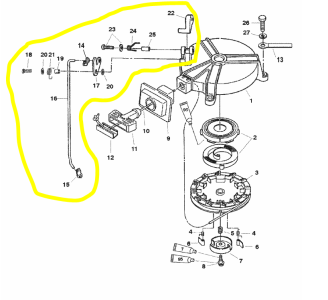

There's what looks like a pawl that pushes up on a lever that disengages the pull cord when in neutral so you can pull it. Check this isn't stuck or blocked. Accessed by removing the cowl.
PS: Don't try and take it apart where bits can fall in the water ;)
What he said; most engines built in the last 40 years have interlocks that prevent starting in gear and they don't have to be very far out of whack to cause a problem.
