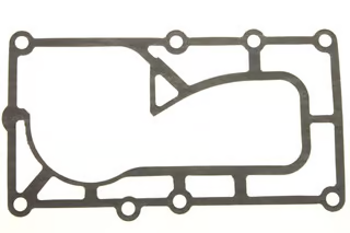

see item 7 being dowel couldn’t find where second one is located ?
This is a picture of the gasket. You know which holes have bolts through them ( I guess one in each corner and one in the middle of each long side).
The dowels will be in the other two holes.
